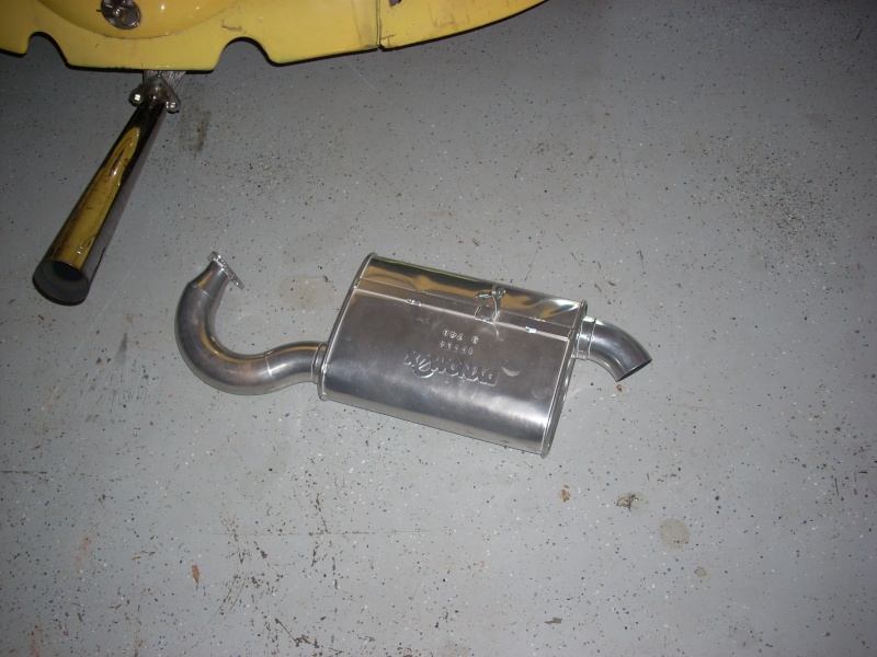

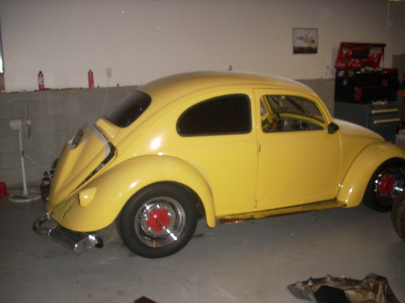

Fixed my exhaust problem, I had to cut and re-weld the flange to 12 o'clock well more like 12:15 position to tuck the phatboy a little better so It will have less of a chance snagging on some crap and really destroying the headers. It probably moved it up about 6 inches... looks a hell of a lot better, all that is needed is a new gasket for that flange. I had to buy some header gaskets for Chevy and cut them up for the exhaust ports, seemed to work better than what was on there.
The rear bearing leak I fixed some how Migrated to the opposite side Evil or Very Mad Time to do it again, I will wait till work to do it, the torque wrench is better there... using a breaker bar and going by feel for torque just didn't do the job I guess, I did break my good 1/2" drive ratchet trying to do that, it just sheared off right into my good 3/4" step up socket. Rolling Eyes
