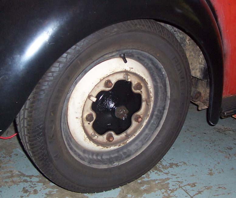

Tires tuck under with the stock narrow axles, no more wide axles

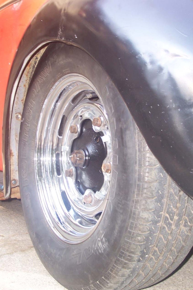

Well, here's an update. The engine is running good so I drained the oil and tried to remove the drain sump plate. It really did not want to come off?? After some easy prying with a putty knief the plate loosened to find a ton of "Red" RTV holding it on?? After careful cleaning, the case opening has been eaten away by water sitting in the case up to the 6 drain plate mounting studs. It was a reconditioned motor when I bought it from Tim's VW. He apparently used a junk case to build it and was also was the one who welded the nut to a head stud??? I let it drain for 3 days and cleaned it real well. I spread JB welded all the pits and let it dry overnight. Sanded it carefully, cleaned the area and had to use RTV very sparingly to seal the oil sump drain plate to the case. Its seems to be dry, but will always be a concern on the filter screen cleaning. The new replacement alternator is working good, but the belt seems to slip still. I have the 5/8" of deflection per the SM, I guess I will try a different belt next. The transmission still hard to shift from 3rd into 2nd, I hope a shifter adjustment will fix that. I had to remove the rear bumper because the tailpipes were hitting it. The late model rear clip does not line the bumper brackets the right way, they angle down touching the exhaust tips.
The next big change I did was using a different set of wheels on the rear. I installed a set of 5 1/2" Mangles with a set of 205's. The rear is down 1 outer spline and it looks good to me. Hope I can pickup the other two 4 1/2" Mangles with 145SR15's for the front today from Dale.
