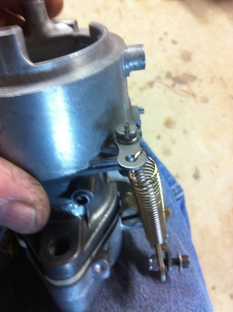

So I picked up some dual Kadrons that needed some work. I did a lot of research mostly provided by the Kaddieshack. I just didn't like the way they put the return spring under the screw. I came up with this, I used a motorcycle chain master link to make a bracket. It doesn't move it too far off of the carb, I drilled the one end a little larger to accept the carb screw. Its hardened so it wont bend. It looks so much better. The only thing unknown is the torque that it will place on the carb body where the screw is. I'll follow up next winter.

Cool Mod. I will do this to my set. Thanks Jim

Torque on screw is negligable should not be a problem. With treated and hardend chain dissimlar metal should not be to much of an issue either.

type4revolution wrote:Torque on screw is negligable should not be a problem. With treated and hardend chain dissimlar metal should not be to much of an issue either.
My thoughts too, but it is still a question in my mind
