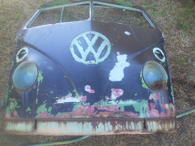

steadily working on the buggy . got seats today for it. going saturday to get a early 60's split dont know much about it will post pics when i get it. been told its a rust bucket but most things i been getting are . hopefully i can use the front end or at least the window frames. [img][/img]
