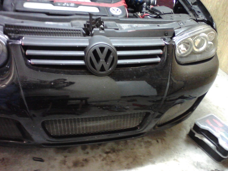

This is what the MK 4 looked like: (yeah it looked like a turd and was broken up...)

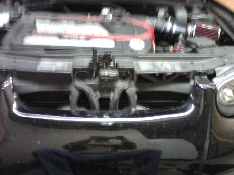

This is what I had been running around with:

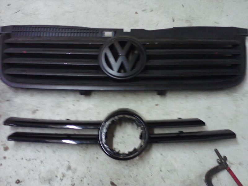

Here is a comparison between the cut up MK4 and the B5.5 grill:
Step one was to remove some pieces:
Step 2 was to remove ALLOT of other pieces

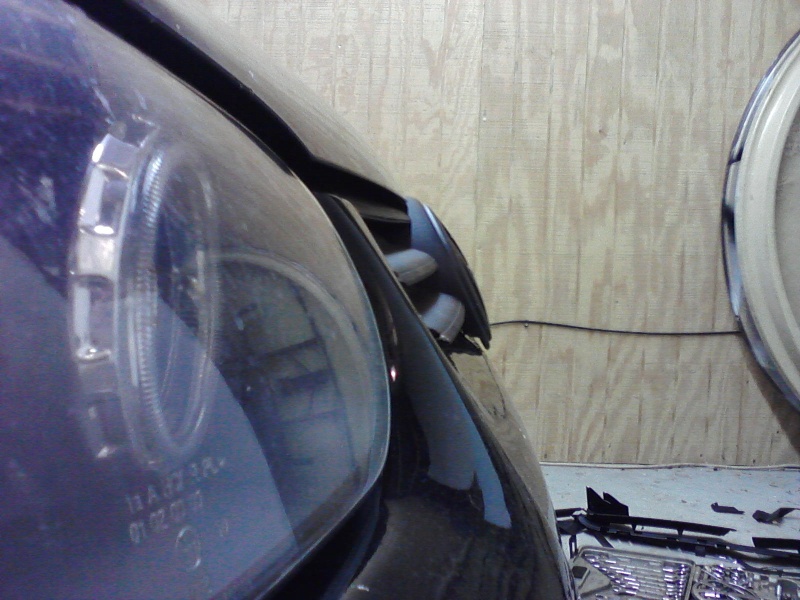

Was able to use the OEM Bumper mounts for mounting! Look how the top rib is perfect with the edge of the bumper, it is almost exact!:
This is one of the ons and offs to get it right, just be patient:
End Result:
Side View (I like the Lay of the B5.5 against the slope of the Eurowise Bumper..):
