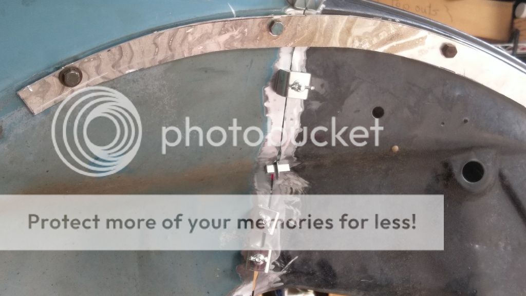

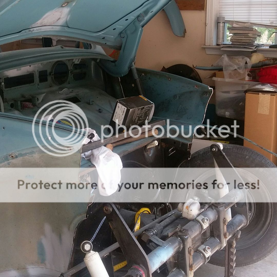

I got the front cut off today.
L390 1962 De Luxe sadan with Sun Roof  - Page 2 IMAG4824_2_zpsjvw1qsay

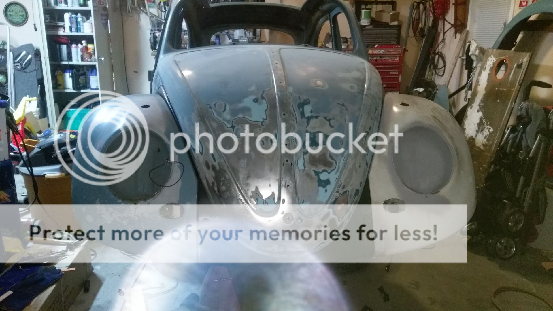

Got the new front up and started fitting it.
L390 1962 De Luxe sadan with Sun Roof  - Page 2 IMAG4826_1_zps3ez7dlux
Almost their, the hood already lines up better than it ever has.
L390 1962 De Luxe sadan with Sun Roof  - Page 2 IMAG4827_zpsxniapufq

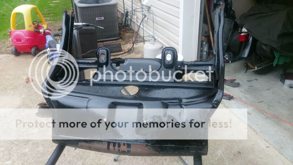

Post by Dake Mon Feb 13, 2017 12:27 am

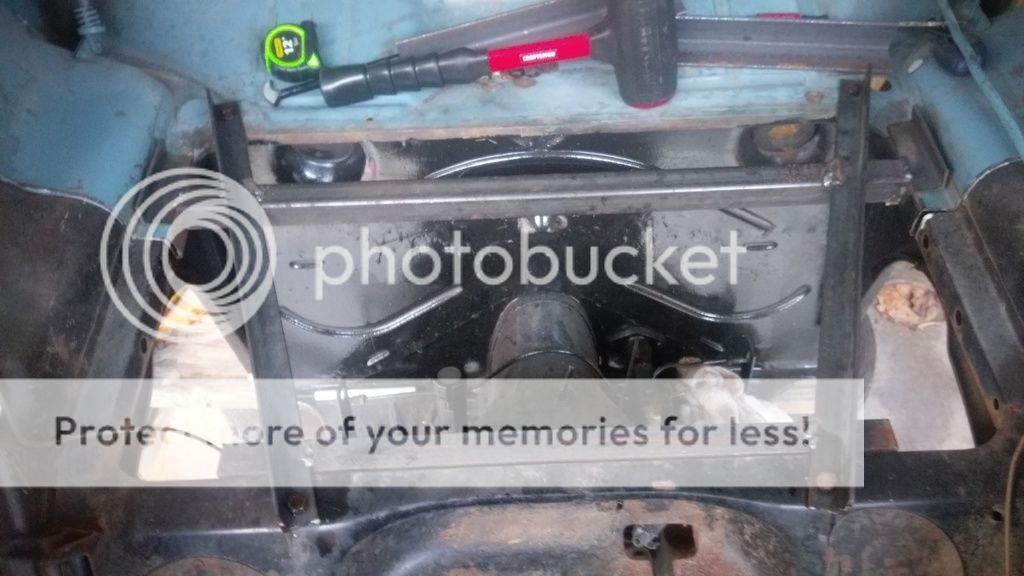

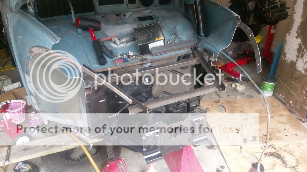

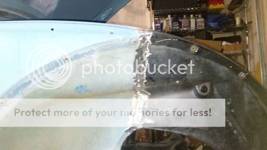

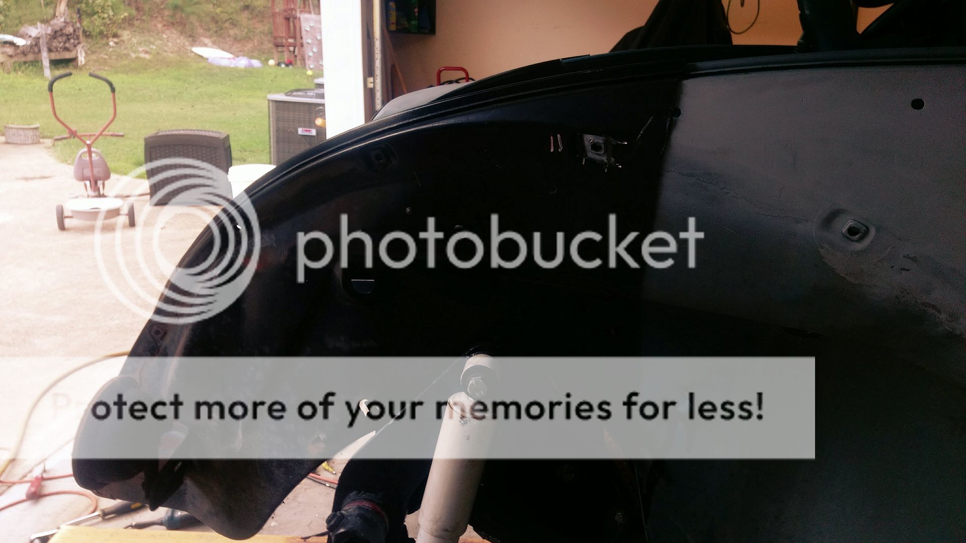

[img]L390 1962 De Luxe sadan with Sun Roof  - Page 2 IMAG5203_zpsrfcubzdt[/img]
Got all the jigs on to hold everything in place
[img]L390 1962 De Luxe sadan with Sun Roof  - Page 2 IMAG5202_zps8ueisifp[/img]
Got the gas tank jig in place
[img]L390 1962 De Luxe sadan with Sun Roof  - Page 2 IMAG5208_zpsjyurrq5e[/img]
Cut threw the over lap and clamped as I went
[img]L390 1962 De Luxe sadan with Sun Roof  - Page 2 IMAG5206_zpsj58yjzz7[/img]
Pulled it off and cleaned up the edges
[img]L390 1962 De Luxe sadan with Sun Roof  - Page 2 IMAG5204_zpstfxasdgj[/img]
Painted some POR on the under side
[img]L390 1962 De Luxe sadan with Sun Roof  - Page 2 IMAG5209_zpsjy8kg1sx[/img]
I tacked it fitted the hood and fenders looked good so I started welding it up. I still need more time to finish it up

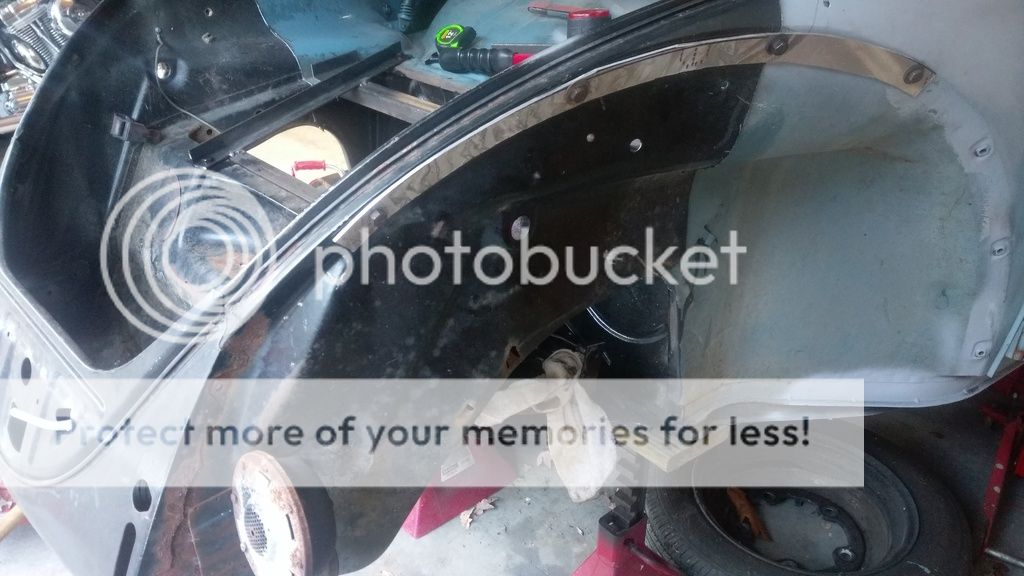

Post by Dake Mon Jul 10, 2017 12:00 am
I was happy to see my pics are still here. Today I got the over rider holes welded up and the trunk seal retainer welded in like I need to get some better picks

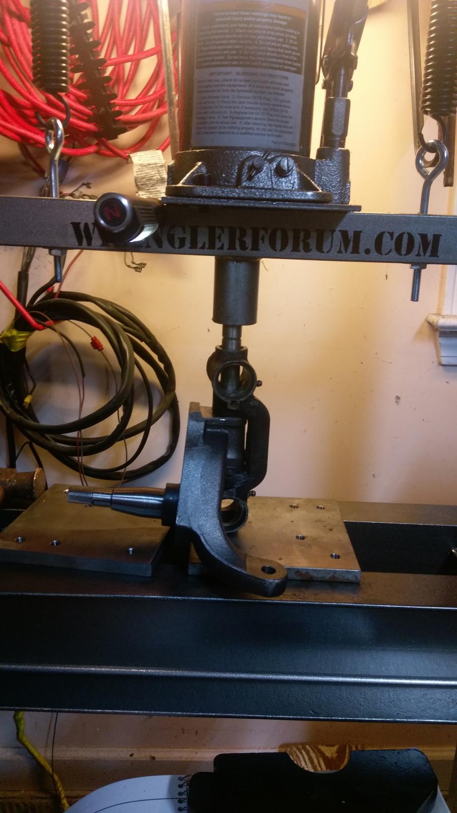

Post by Dake Fri Oct 13, 2017 1:56 am
I got the Empi set with drop spindles. Had to redo my king pins again so I also bought the reamer. Now I have a set of drop spindles for drums on the shelf . I still have more work before I'm back on the road . Need to get my freeway flyer in I got from Benco

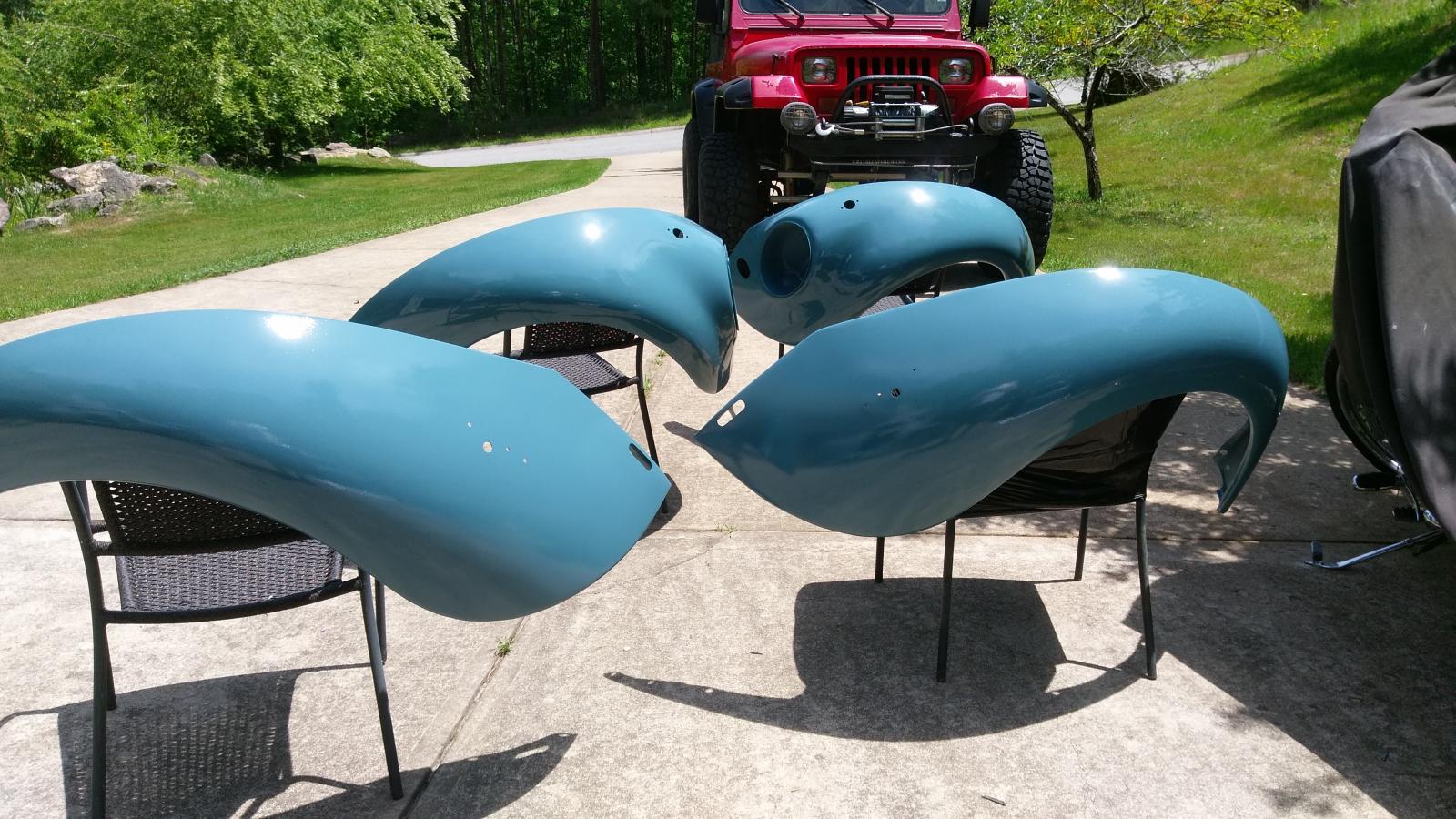

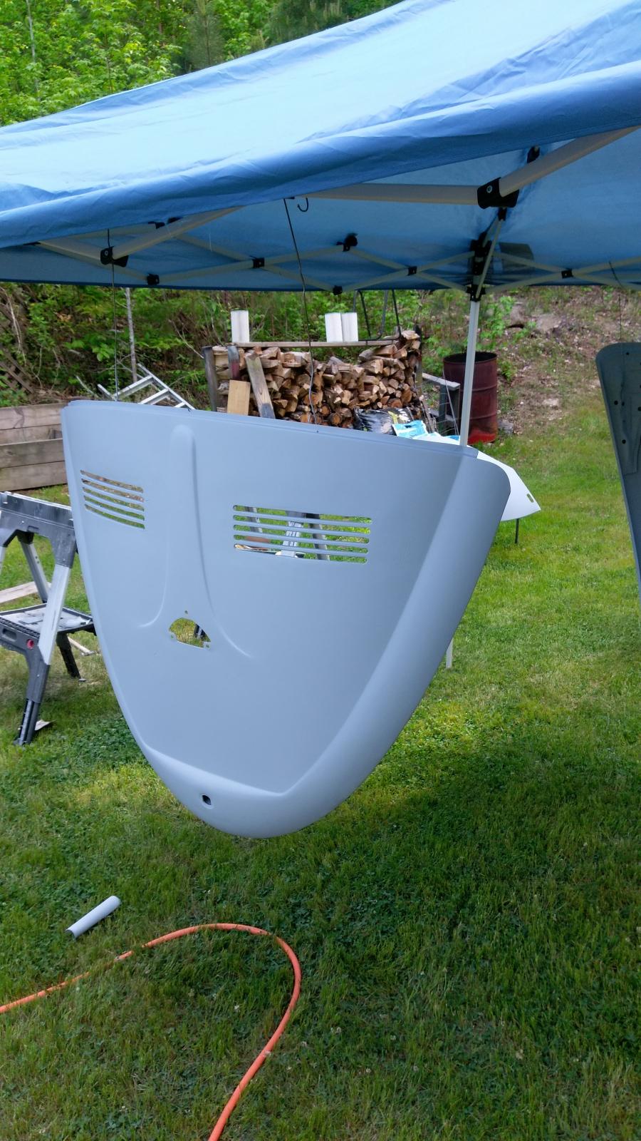

Post by Dake Sat May 05, 2018 8:37 pm
[img]L390 1962 De Luxe sadan with Sun Roof  - Page 2 1776028[/img][url=L390 1962 De Luxe sadan with Sun Roof  - Page 2 1776029]Deck lid in primer [/url][url=L390 1962 De Luxe sadan with Sun Roof  - Page 2 1776030]Pain[url=L390 1962 De Luxe sadan with Sun Roof  - Page 2 1776682]Doors getting painted [/url][url=[url=L390 1962 De Luxe sadan with Sun Roof  - Page 2 1776684]One more back shot [/url]L390 1962 De Luxe sadan with Sun Roof  - Page 2 1776683]After two years I got paint [/url]ted fenders [/url][url=L390 1962 De Luxe sadan with Sun Roof  - Page 2 1776681]Fender beading sample [/url]
Number of posts : 148
L390 1962 De Luxe sadan with Sun Roof  - Page 2 Empty Re: L390 1962 De Luxe sadan with Sun Roof
Post by Dake Sat May 05, 2018 8:39 pm
Still got to color sand and buff but the paint is on it. Hope to be on the road this summer!!
