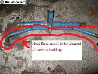

Post by Attorney Isaiah Loophole Fri Jan 02, 2009 6:48 pm
You are experiencing icing. To fix the problem you need to clean the heat risers if they are connected to your exhaust and run a preheater hose. I will look for pics.

Post by Attorney Isaiah Loophole Fri Jan 02, 2009 6:59 pm
Air Intake tube freezing? HeatRiser
He is some suggestions on how to clean it http://www.thesamba.com/vw/forum/viewtopic.php?t=67496&highlight=heat+riser+clean

Ok thats what i was looking for THANKS guys, only thing is i dot have the stock airfilter and not stock exhaust, so the heat tube prob. wont work but i guess im gonna have to take it apart and clean the heat risers and see if that does the trick, and with the link i saw they use a clutch cable on a drill to clean it, guess ill need to find one of those too! fun fun!! maybe because im getting on the road soon ill just park it for now, ive spent enough $$ on it this tour at home to last a while.. I got a bamboo rack today!!! hehehe $25.00 couldnt pass it up, oh well something to do next time. Thanks again!!!!

Sometimes the clutch cable trick does not work. I have had to cut the tubes in order to get them clean, then weld them back up.
Good luck.

Heating the pre heat risers with a torch and then cooling them quickly with water will cause the carbon to crack and make it easier to get out or just fall out. I have done this amnt times with sucess. Try this if you get the time.

Post by daltondragger73 Mon Feb 23, 2009 9:23 am
votwing wrote:Heating the pre heat risers with a torch and then cooling them quickly with water will cause the carbon to crack and make it easier to get out or just fall out. I have done this amnt times with sucess. Try this if you get the time.
Heat did work a bit we also banged on it with a hammer and alot of stuff came out.. but what I did try and it worked real good was went to Wal Mart and got a 6 dolla bottle of Mineral Spirits set the tube proped up side down pored the M.S. down in the risers let it sit over night then dumped it all out when it dried knocked it with a hammer a couple times and WALLA!!! it was so clean cheers so its back on and runnin good!! also the thing is like twice as loud as b4.. so bug-a-paluza loudest engine here i come!!!
