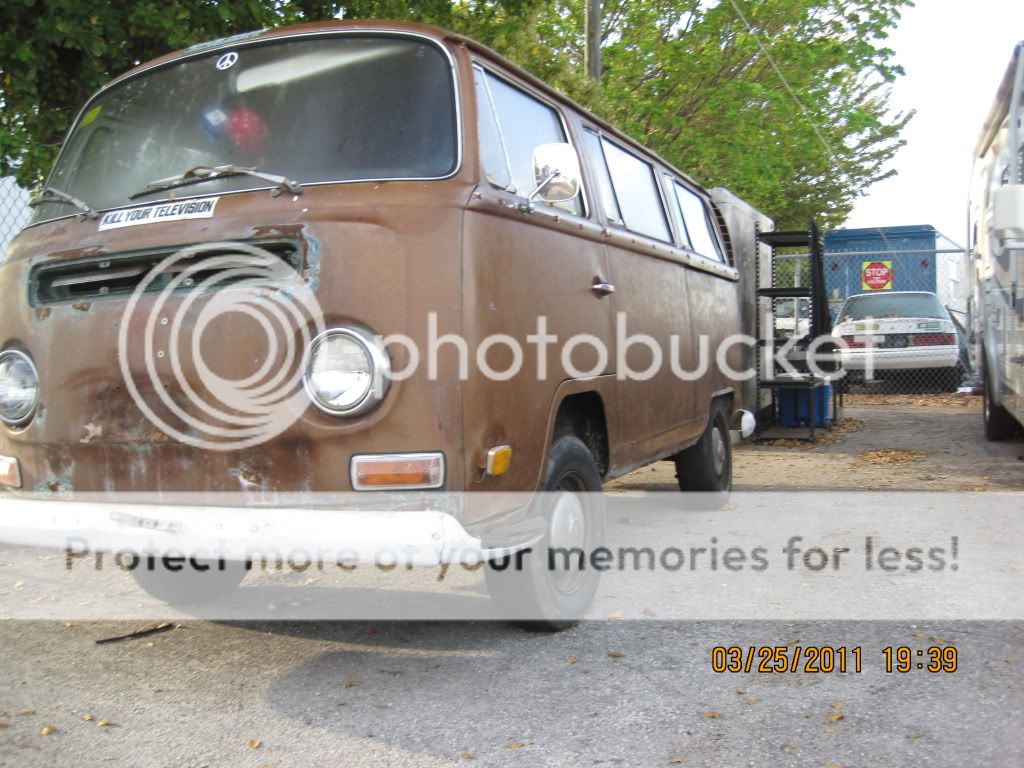

Ok so I'm finally getting back into a VW Twisted Evil I found a Bay and the guy tells me its a 70 tags inside the door say its a 70 but it has a small 5 lug pattern & disk breaks up front scratch I was told its prob. a early 71???? but taged a 70?? need some insight!! first bus
I went back to it today and spent over an hour looking it over, 1600dp rebuilt about 3yrs ago only has 20k on the motor since trnny shifts fine OH and it started right up after sittin 4 months. Underneath/floors are decent some patch work has been done by current owner,support rails (side to side) have rust at edges looks fixable, frame rails (front to back) are solid, heater channels are coverd by a insalation so cant see them, battery tray normal rust, engine comp. looks real good new seals (@rebuild) body is straight, a lil dent in the nose and passenger rear corner looks like someone hit it with a hammer Neutral around bottom edges of the body there is rust that has been patched and coverd with bondo Rolling Eyes but you can only tell if your up close, the roof is real good!! windows all work doors all open and shut with no problem, paint is not Og and its a crappy job, brown is not my choice of color, kinda looks like a SH#* box, no pun intended!!the og color is green and white can see it in the door jams, Its a transporter so no walk thru, altho it does have the clips for delux trim!! my thought is to fix the bottom rust, slam it and drive it and do the rest slowly Ill get pics as soon as its all paid for and back to my house

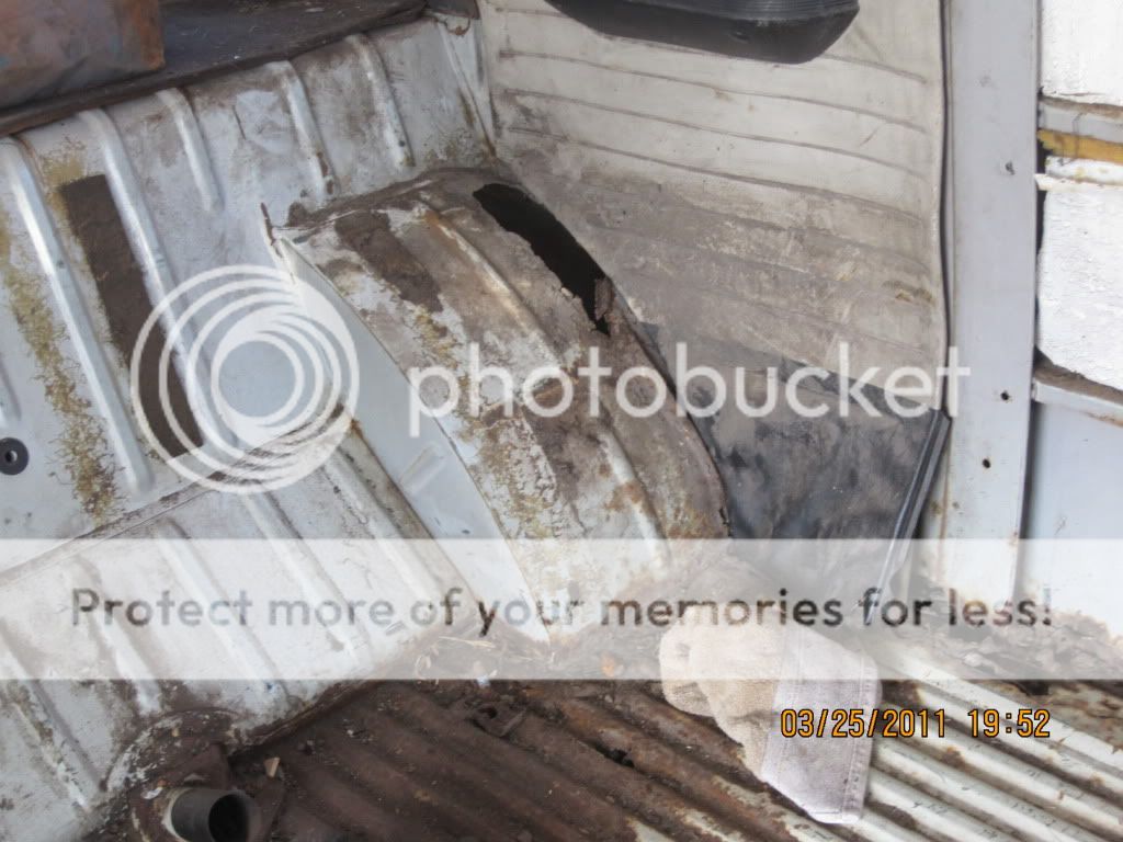

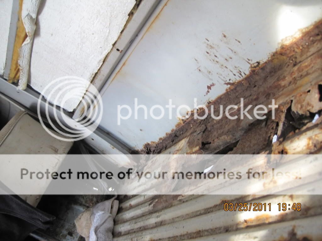

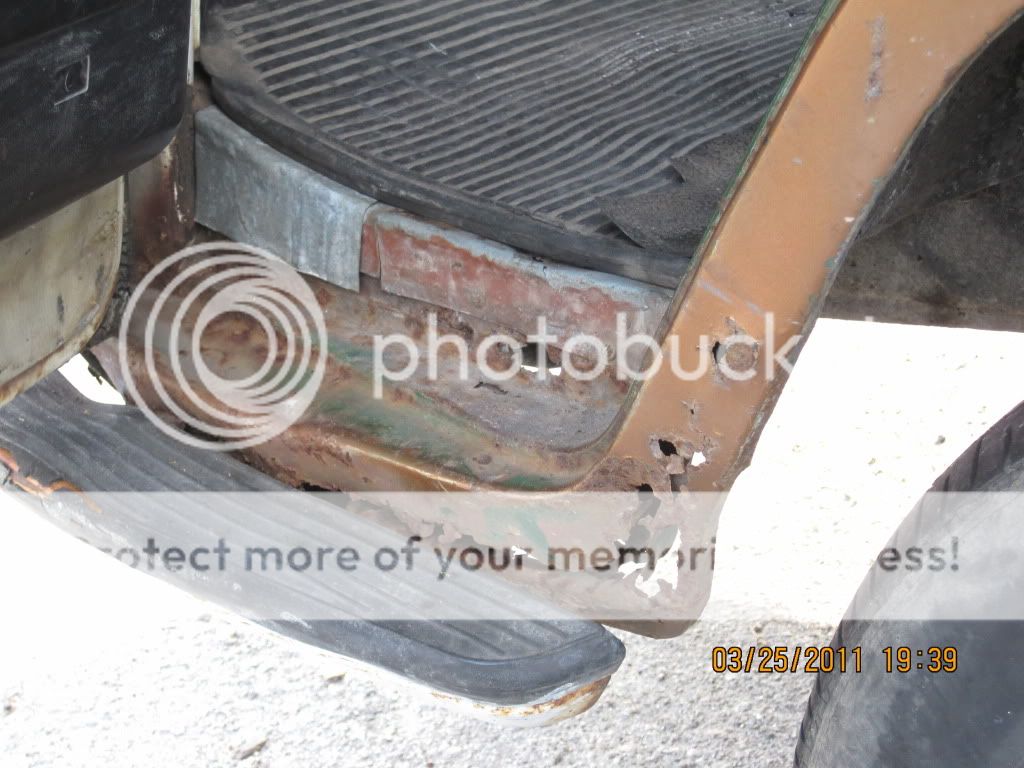

Now for a even better ? I finally picked it up so i will get the m codes looked up, but my real issue!!!!! i picked it up got it to my place cleaned it out saw alot more floor rust once all the junk was out of it also got under it again and WOW im scared!!! cross members need to be replaced yada yada yada but I found alot of rust left rear frame section around the torsion bar can that be cut and welded with a new rear leg??? or im out 800 bucks with a bus thats unfixable

Post by meinvw Wed Mar 16, 2011 10:49 am
Maybe get some pics of the area and can see if its worth fixing. It is fixable, but worth fixing is another question. My 73 is like that but the worst on mine is the front beam. it has actually broken 3 times. Have a ton of scrap metal patched into the breaks and still drive it. Floors were the same, sheet metal and some screws and its fine.
the first time the beam broke I was driving up in Va and had to hit the brakes hard and the front end went POP! That thing was all over the road the rest of the trip. Took me 11 hours to limp it home (after the campout of course) but you should see my seat after all the pinching comming down the mountain!!!!!

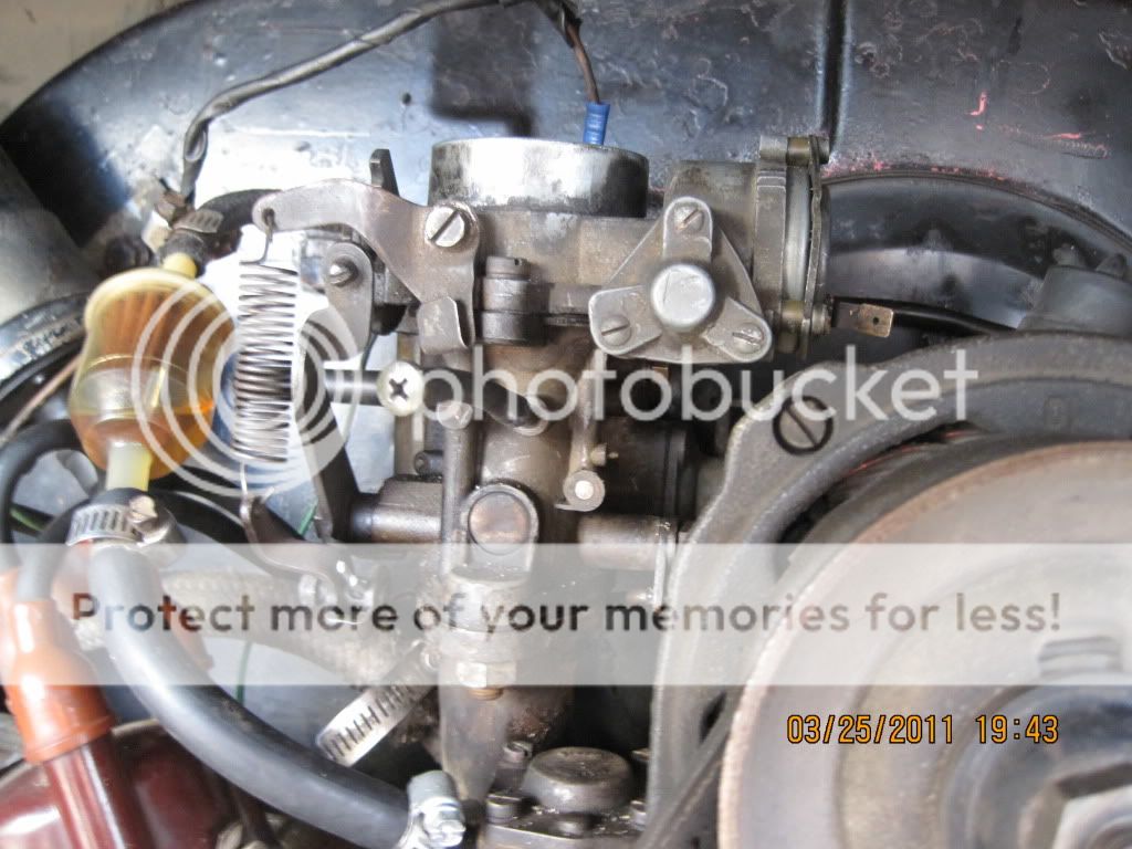

sum to think about, would like to get the bus goin by then but???? Chassis, Gotta drop it,get new tires and get it runnin,
starts up good but if u let off the gas it dies right out??? I drove it around the block It was tough to keep it runnin.. prolly do the carbs RIght??
Number of posts : 334
Location : Dalton GA.
70 or 71 Bay? Empty Re: 70 or 71 Bay?
Post by DOODLE BUGG Sun Mar 20, 2011 10:23 pm
i would check for vac leaks thats usely the problem i find

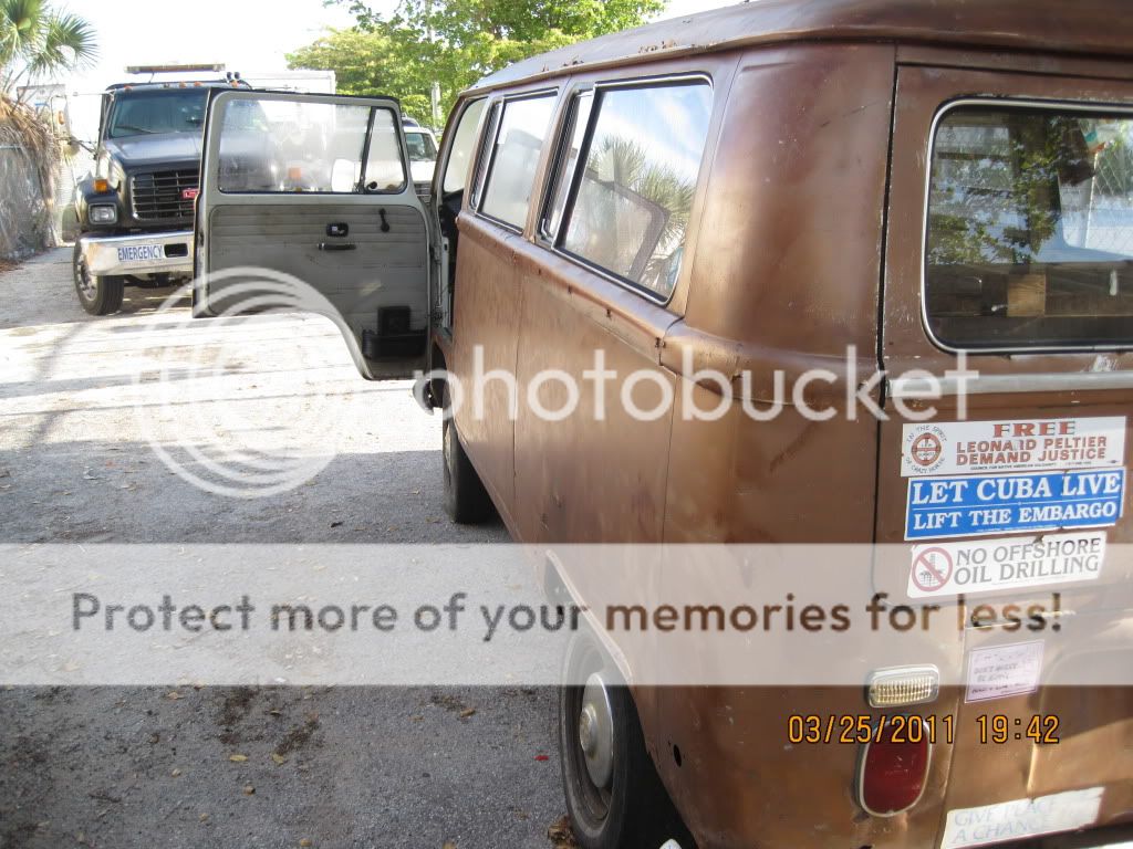

Here are a few of the bus
70 or 71 Bay? 498
70 or 71 Bay? 497
70 or 71 Bay? 506
70 or 71 Bay? 507
70 or 71 Bay? 505
70 or 71 Bay? 499
70 or 71 Bay? 500

Post by daltondragger73 Sat Mar 26, 2011 9:45 pm
70 or 71 Bay? 501
70 or 71 Bay? 520
70 or 71 Bay? 522
70 or 71 Bay? 518
70 or 71 Bay? 524
70 or 71 Bay? 523
70 or 71 Bay? 518
[IMG]https://i364.photobucket.com/albums/oo83/daltondragger/519.jpg[/IMG
70 or 71 Bay? 516]
70 or 71 Bay? 509

Post by daltondragger73 Sat Mar 26, 2011 9:58 pm
DOODLE BUGG wrote:i would check for vac leaks thats usely the problem i find
I think theres a couple issues with this one
70 or 71 Bay? 510
