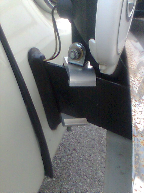

Atye,
I had the same thoughts for the foglights on ASBug, I went to a shop that installs tonneau covers on pickups and they gave me some of the "little" mounts that the covers come with, I took these parts and used a 3.5" stainless carrage bolt to thread it through the V in the front bumper bracketts.
I know that the earlier models bracket is different, but I believe you could trim the excess off these aluminum brackets for mounting just to the outboard side of the bracket. (sort of like the second photo.) This is what I plan on doing to Betty when I get the bumper mounted... With the use of these aluminum clamps and the stainless bolts, you shouldn't have to worry about rust, and the aluminum can be polished.
(Yes, I did change the wires on the lights to be yellow and brown to match the rest of the wireing....)
Just a thought, I've had mine on for 2 years now and love them, the new hellas do not get hot enough to melt the covers. I never take them off. Even with the covers on, I can see well enough to drive at night! I cannot imagine how bright they would be without the covers....
