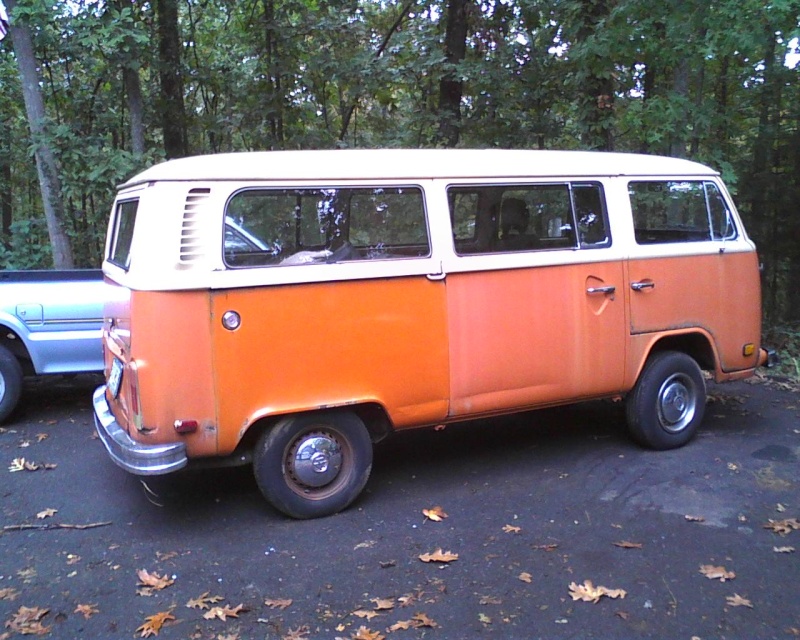

Story is:
A guy texts a bud of mine on Friday and states that the city is going to tow this bus off on Monday if he doesn't get rid of it.
3 flat tires, engine turns over, has title.
That was the message.
Bud is out of town, so I get the call to go and look.
As found (and Bought):
'78 Bus "Fozzie the Bus" 12100610
'78 Bus "Fozzie the Bus" 12100611
'78 Bus "Fozzie the Bus" 12100612

Bus has the OEM hydrolic 2.0 and has some paperwork since new.
I'm the 3rd owner.
Fuel pump and some vacuum hoses and it is good to go.
Need Tires.

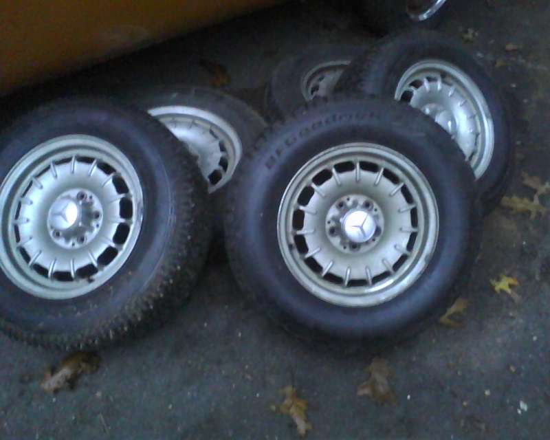

Got some new shoes for the bus...
Found an add on CL for some 300D Mercedes wheels: (got 5 of them!)
'78 Bus "Fozzie the Bus" 12101110
'78 Bus "Fozzie the Bus" 12101410
'78 Bus "Fozzie the Bus" 12101411
Looking good, and the BFG trail cutters on the back are meaty.
Front = 195 60 14's
Rear = 205 60 14's

Don't forget to consider changing those wheel studs. I was nervous with 1/4" of the lug nut grabbing the stud. Looks good!

It is only 2.5 threads exposed on the nuts.
I'm cool with that.

Wow! Looks good. So these wheels bolted rt up w/o changing the stud length or boring out the center???

Yep they did.

You can either get longer studs and different lug nuts to mount them or do as I did and knock out the little steel inserts for the Merc lugnuts, and presto, the standard VW bus nuts / lugs work great when the inserts are removed the angle is perfect for a VW lugnut..
They look good and are still 14"

Nice! I had picked up a set of these w/o any research on them thinking I would just slap them on and that would be the end of it. Didnt really pan out that way. Had to bore the centers on the front wheels and get longer studs for all of the wheels.
