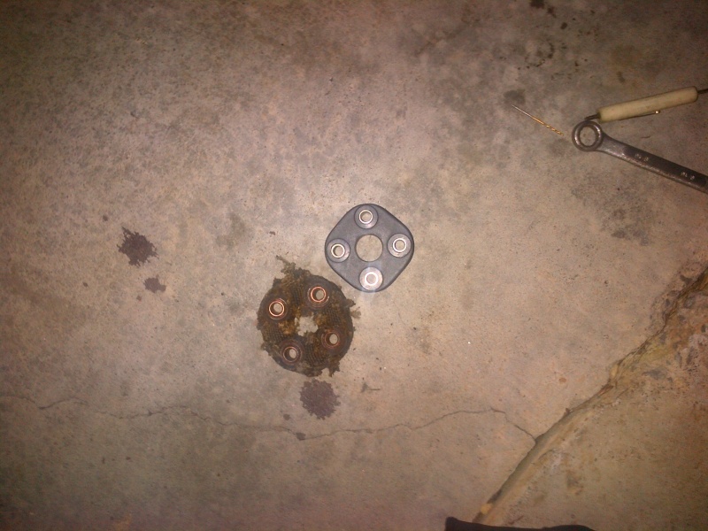

Post by LB Bedwell on Tue Feb 05, 2013 10:14 pm
changed out what seems to be the OG rag joint, man what a difference, got the carb acting better, so Im gonna put her in the wind tomorrow to work and see how long til another OG something goes
