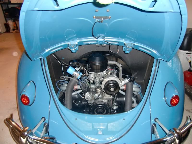

It looks like you still got a ton of room in your picture, you'd likely be ok, but I really can't say for sure.
Number of posts : 3855
Re: generator light
Post by fluxcap on Wed May 04, 2011 10:49 am
Here's a pic of mine when I switched over to the alternator. You can see how close the mushroom style pump sits.

Well, I'd probably order another pump (and correct length pushrod!) just for the heck of it. Then get your alternator and see if it fits with your current pump. If it does, then keep your current pump on there and keep the replacement in the car as a back-up. If the current one doesn't work, you'll have the new one ready to install.

Fuel pump will work. You just have to get the alt lose when you have to switch the fuel pump (if it breaks). I'd wait till the fuel pump breaks before I replace it.

your current pump will work....to change it no need to loosen the alternator....just take loose the top screw and pull the cap off the pump that will give you enough room with the alternator installed to remove and replace the pump
