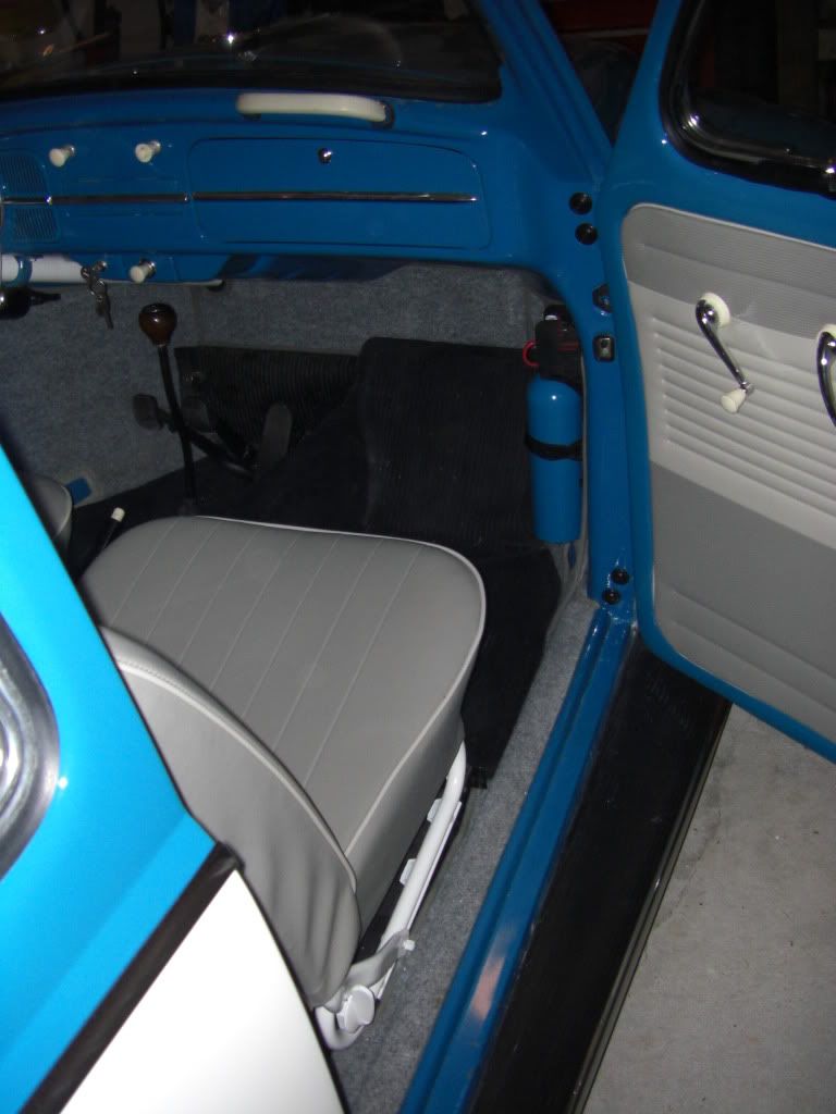

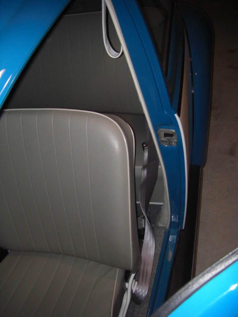

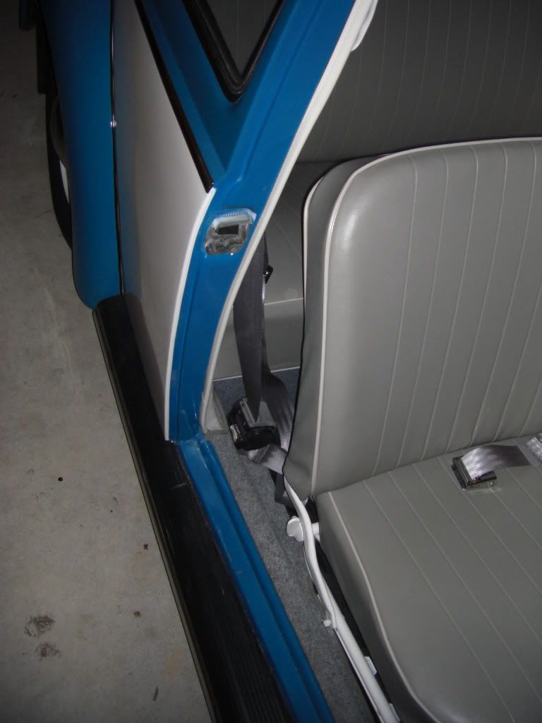

When I dropped it off at the painters, I didn't really specify how I wanted the jams, so this is how he decided to do them.
The white does wrap around into the jam, but only about a quarter of an inch. If I did it again I would probably specify to wrap the white around to the the line/bend where the striker plate is.

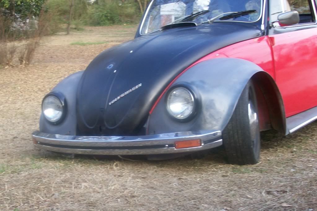

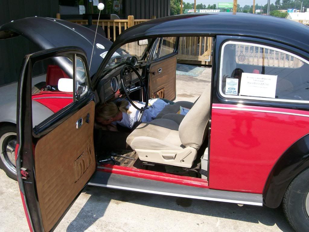

Post by Damn-it Don on Tue Dec 22, 2009 7:40 am
Here is my take on it. ABout the same as Fluxcap, thought I'd include back edge of door too.
I Kinda like the samba version, makes for a cleaner look at the joint at the heater channel (mines all red)

**NOTE***
It seems to be better to divide the colors at the trimline, not the body line above it. I have a red line where my hood, quarter and fender meet....oops.

Here are a few more pics. If I did another one it would be a combo of mine and Don's Laughing . I really like how the red on Don's goes all the way to the corner on the side jams. But I'd like to keep the bottom rocker section the main color, mainly cause when you are sitting in it, you still see some of the rocker and it would drive ME (just my OCD) nuts not matching the rest of the interior paint.
two tone paint CIMG5762
two tone paint CIMG5759
two tone paint CIMG5756
two tone paint CIMG5757
