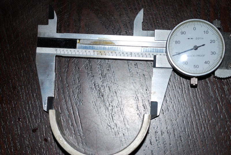

Could someone please identify the main bearing size for me? It is an original vw part # 131.105.531
Thanks,

65.0mm O.D

Where did you find that? So 65MM OD refers to the case line bore? I know the crank is standard or should be as the rod bearings are std.
I am trying to identify the correct replacement main bearing set using a rebuilt crank .25mm. The question is, what is the line bore?

Sorry, I thought you meant physical size. I found it on Old Volks and confirmed on three other sites. Not sure about the rest of you questions.

I measured the outer diameter of the bearing. Looks like about 2.57"

If the bearing diameter is 65 mm, what is the standard bore size?

EngineerTEN wrote:Hmm...
=65.27800 millimeters

Sorry, all my T1 mains are numbered 111 198 4_ _
T4 are 021 198 4_ _
I'd just measure what you have and convert to MM.
Std case is 2.560"
Std crank is 2.165"
std thrust is .867"
